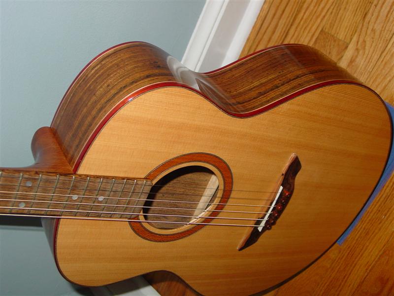

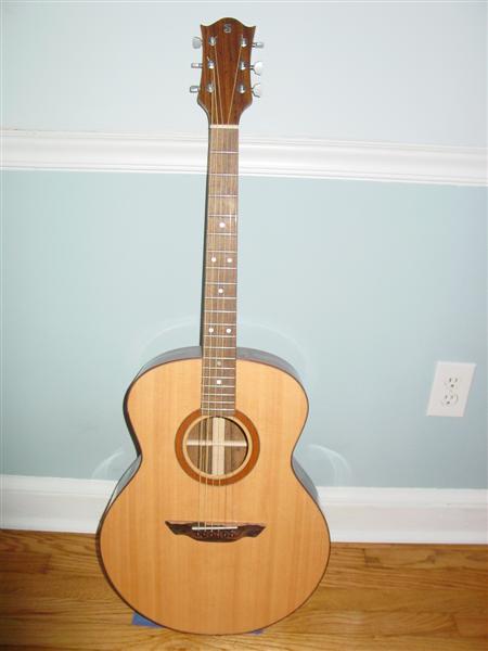

Well, this guitar was sort of an experiment. It is an OLF SJ and full of mistakes, but I decided from the outset that I wouldn't spend too much time trying to correct them. I mainly wanted to see how the bocote and douglas fir top would effect the tone of the guitar.
It turns out that this guitar is the sweetest sounding out of the 3 that I have built, and has really great sustain. It sounds similar to cedar topped guitars I have played but the highs seem to have more "shimmer". The only drawback is that the top starts to break up a bit with hard strumming - this is definitely a fingerstyle guitar.

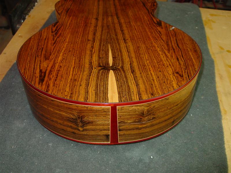

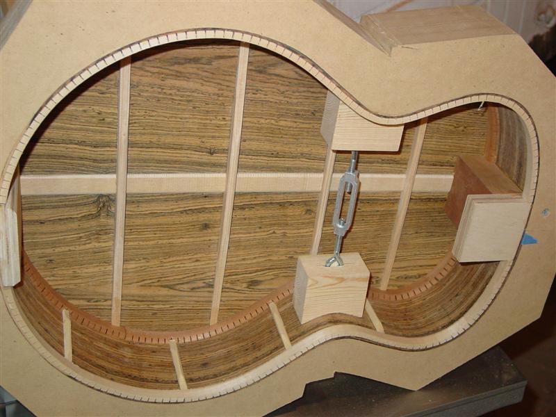

I'm still not sure how I feel about the Bocote. Since I've finished the guitar there have been numerous cracks popping up on the sides and back, and I also had trouble with the sides cracking during construction. This might be a result of the sides getting thinned too much when I was sanding, but I didn't expect it to crack after the nitro was on there.

Finally a bocote guitar. Doug fir too. Karl that looks great. Bocote is the same family as Ziricote.

Very nice guitar and great pictures. How does she sound?
PostPosted: Tue Jun 27, 2006 9:57 am

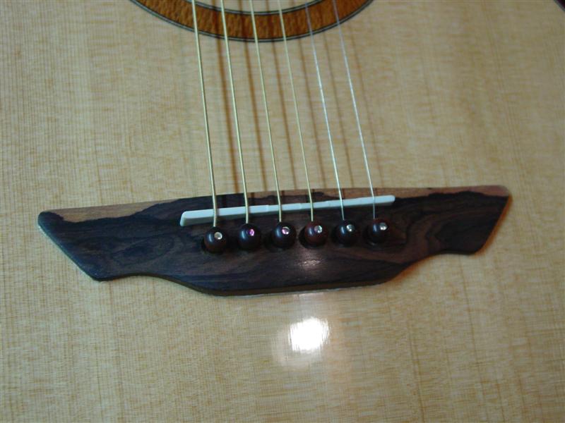

Very beautiful guitar Karl, excellent craftmanship and great taste in bridge design!

It is a beautiful guitar, very finely crafted. I see what you mean about the bocote, very pretty but disappointing performance...

I wouldn't take that to mean all Bocote is going to crack just like all Ziricote or all Brazilian RW doesn't crack. I have bent Bocote sides without cracking. Probably just that particular piece of wood. It is very beautiful.

[QUOTE=ksudar] It turns out that this guitar is the sweetest sounding out of the 3 that I have built, and has really great sustain.-Karl[/QUOTE]
Yeah, but here's the maddening part...is it the wood, or your improving building skill?
Nice looking guitar, BTW!

I was intersted to read your assesment of the Douglas Fir Top, I'm just making one with a Douglas Fir Top, it has a reputation for being very responsive, but lacking headroom so thats consistent with your comments.

I much prefer the look of that to Ziricote, and you've used it to produce a very nice clean looking guitar. I'd be interested to hear the Douglas fir top, that to me is the most interesting aspect of this guitar. So, Karl any chance of a sound bite, Russell, when you've done get it down to Bristol and record it!

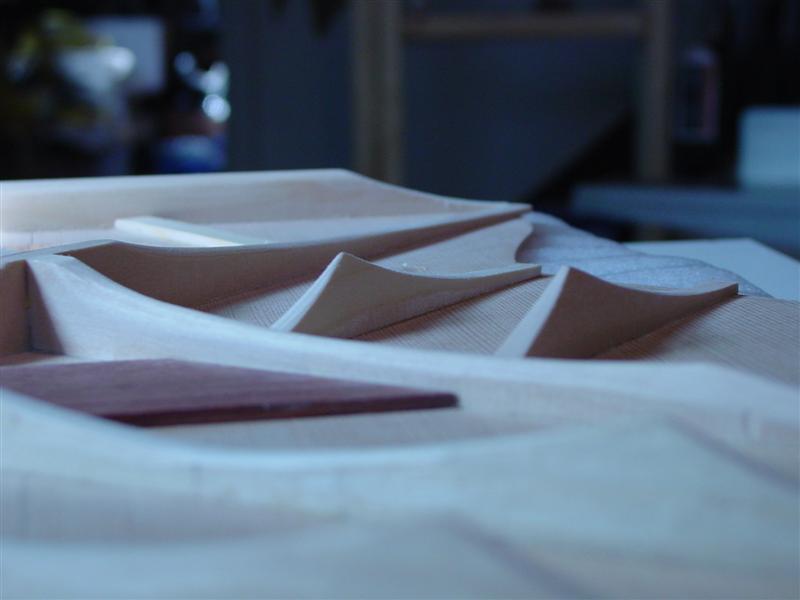

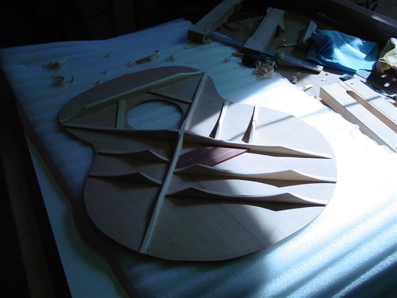

Nice clean workmanship (you DID cap that X-brace joint after the picture was taken, right? ; that's what your get for taking such clear pictures!)

    That Bocote and D. Fir are awesome! I really like your bridge design and the bloodwood bindings are outstanding too. Beautiful!

WOW! That bloodwood looks fantastic along side the bocote! Nice work!

Thanks for all the kind words!... and yes I did cap the X-brace! I wish I could post some sound clips but I don't really have a good setup for recording - I'll see if I can come up with something in the next few weeks.

The funny thing is that I just started my first commissioned guitar, and the client saw this bocote and wanted the same wood for his back/sides. So I'm a little nervous about using the bocote now, but the set I'm using for his guitar is much more stable than the wood I used for #3. That wood came from a hardwood dealer and I have doubts about the way it was dried.
